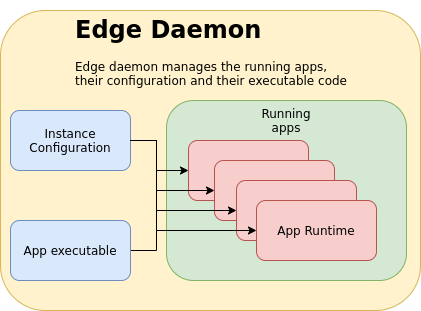

# Architecture (gateway)
All programs on the Gateway is run inside the IoT Open Runtime (iotopen-rt). The
runtime handles authentication of the gateway to API:s and on MQTT. The program
managing the Edge-apps is called edged
The edged
program consists of several layers. The daemon itself handles
fetching of configurations, updating the apps version and doing callbacks into
the running environment of the app. Each app is started inside an abstraction
layer with a socket connection to the daemon. The socket is used for RPC
communication from the daemon. The edged
software also downloads the
executable code and injects the user configuration into the environment.
