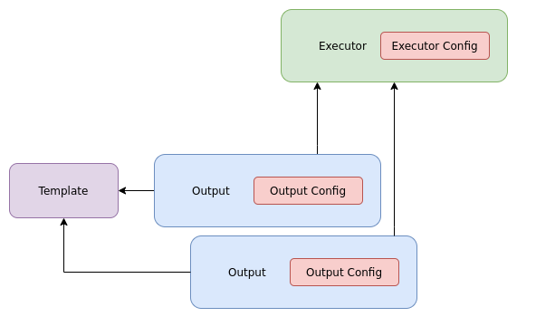

The notifications consist of several parts that come together to form a chain of actions to deliver the message to the user. There are three main parts, message template, executor and output each described more in depth below.
This picture illustrates the connection between the different parts to form the message to the user.
fig1

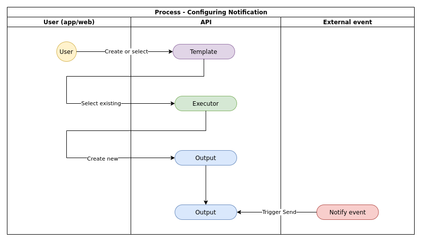

This image is an example of expected flow for users or systems to create a new notification.
fig2
