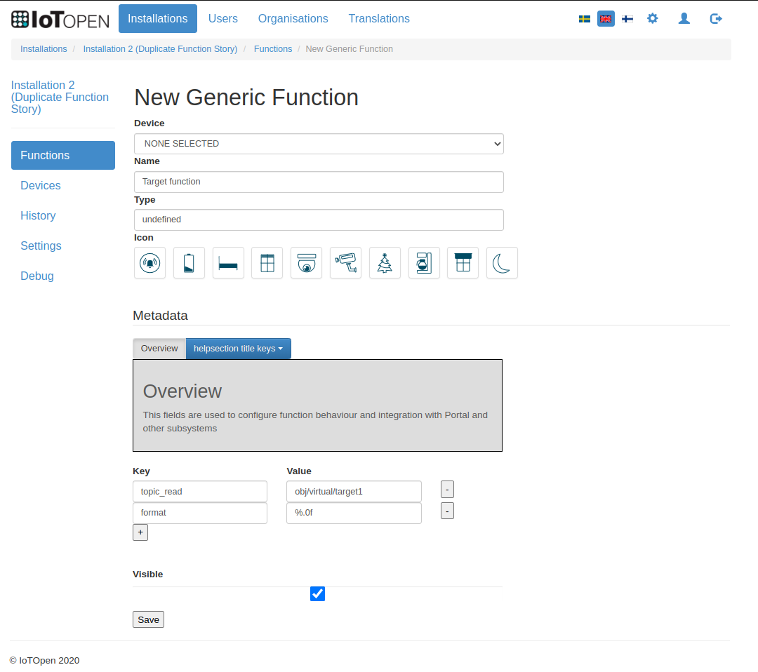

The target function is easy to create. It can be done via the API or via the Web GUI. Here are the steps needed on the Web GUI.
  • Open the target installation "Installation 2" in my case.
  • Click on Functions
  • Under "Add function" choose "Generic Function" and click "Add".
  • Give the function a Name "Target function" in my case. Can be anything.
  • Type should be the same as the incoming function. In my case "undefined".
  • Add the medata-key "topic_read". I set it to obj/virtual/target1. It can be anything but must start with obj/<something>/<identifier> and should be unique within this installation.
  • Optional: Set a format string for the function
Below is a dump of my screen:

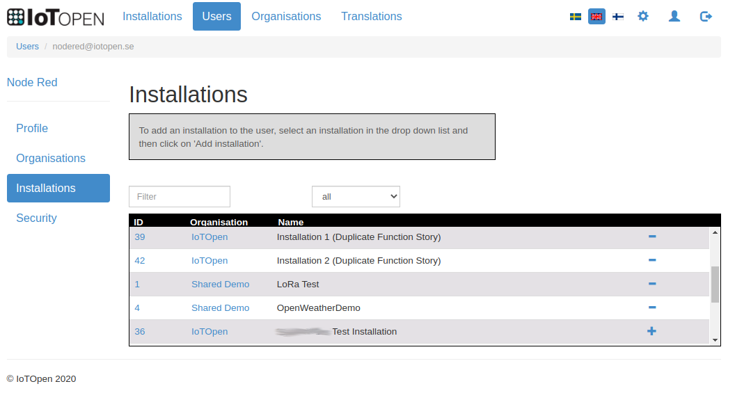

# Make sure the user can access both installations
Then you have to make sure the user you are using in Node-RED has access to both installations. Open the user on the web GUI and make sure both installation are listed with a minus sign. If there is a plus sign, click on it to add the installation to the user.

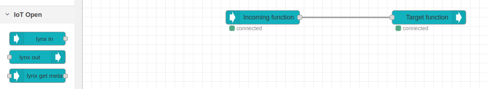

# Make a simple Node-RED flow

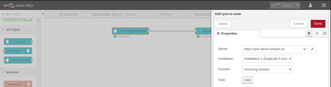

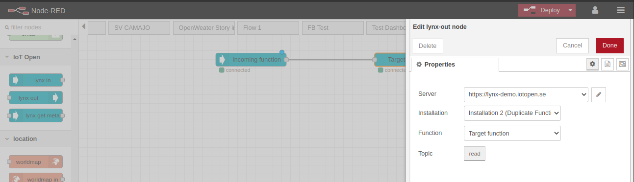

Now all that is left to do is to create a Node-RED flow. The flow only need two nodes. One Lynx in and one Lynx out. Drag them to a workspace and connect them. In the Lynx in choose your incoming function and in the Lynx out choose your target function. See the images below.
