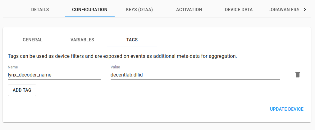

Specifying decoder by name
It is possible to specify a specific named decoder for a sensor in ChirpStack. This might be needed if sensor type cannot be determined automatically. To do this, add a tag called lynx_decoder_name on the device in ChirpStack.
Example
This is an example of a device with the decoder name tag set.
decoder_name_tag
Device with decoder name set
