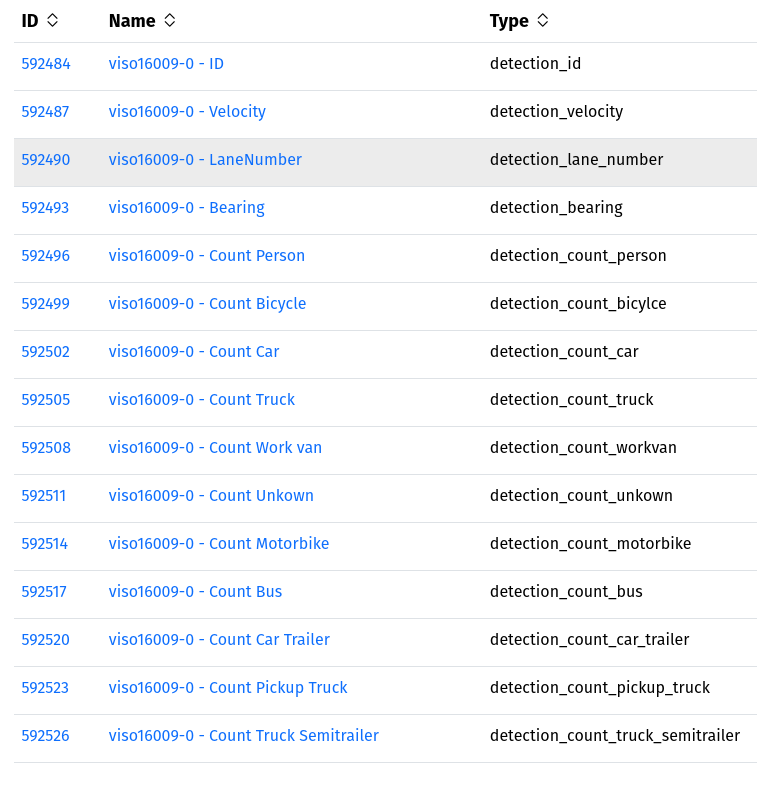

Functions created
Functions for each type of vehicle that can be detected will be created. Function value represents how many of that vehicle type were detected during that specific detectionfunction list

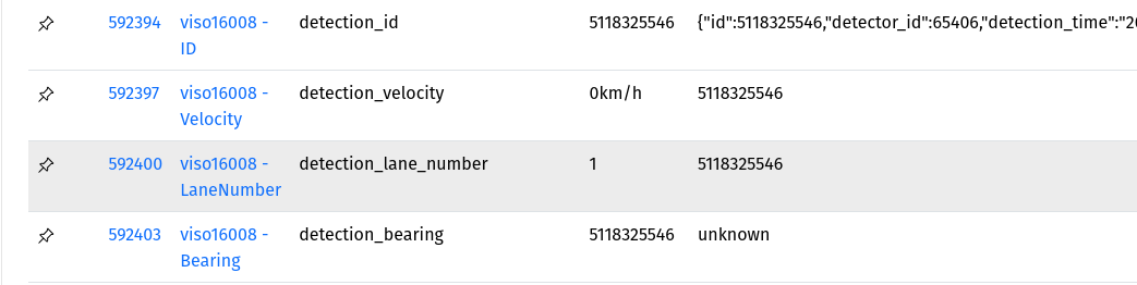

There will also be functions created for detection_id, velocity, bearing and lane number. function list
