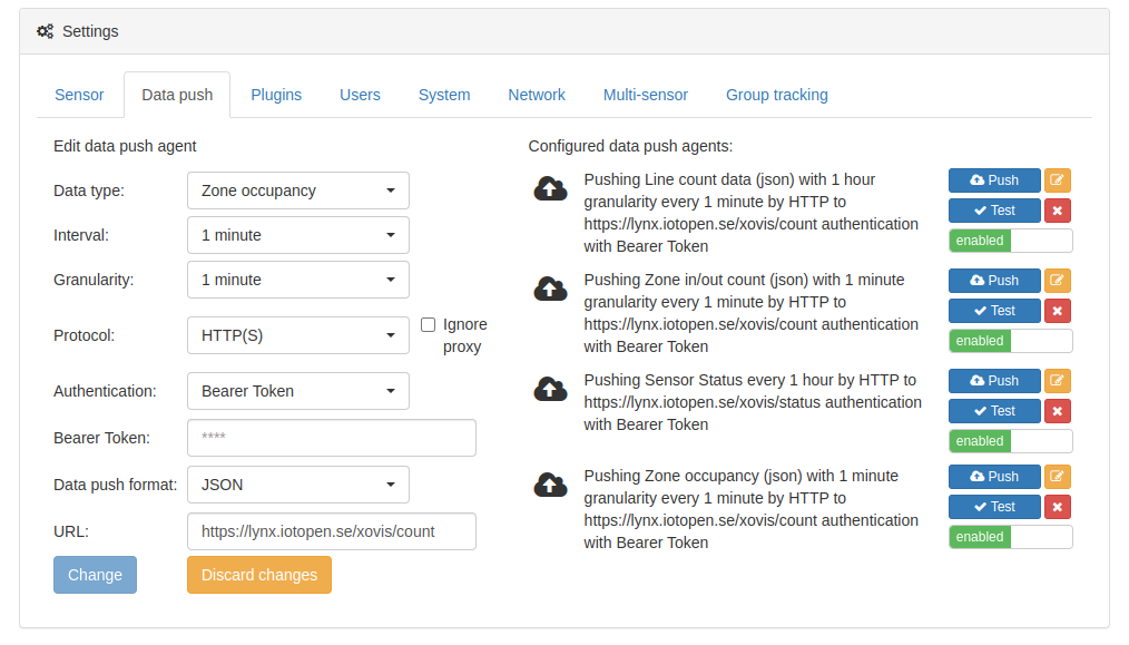

Data push
Each type of data push setting needs to be set up using the web-interface on the device. Only some of the data-types are supported. The interval and granularity settings can be used as desired.
Authentication to the IoT Open platform needs to be set with a Bearer token received from your platform representative together with the correct URLs.
All Data Push objects need to be set to the JSON format, except for Sensor Status where XML is the only format.
Example configuration:
xovis_data_push
Data push example
