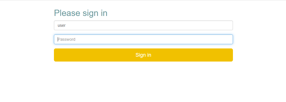

Open a web browser and connect to the IP of the gateway. A login page should now be visible like this: inteno-1
Log in with the admin account. Default username is admin and the password is different for different systems.

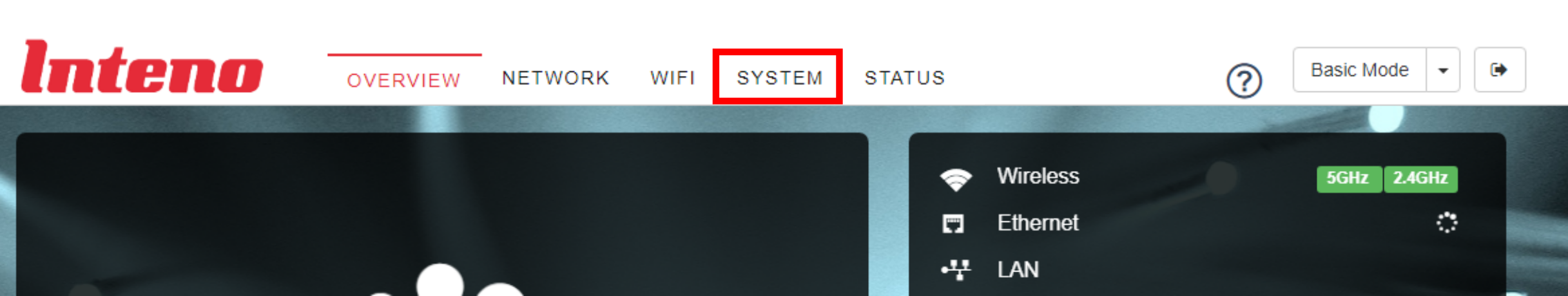

Once logged in, go to the menu and press System in the top menu. inteno-2

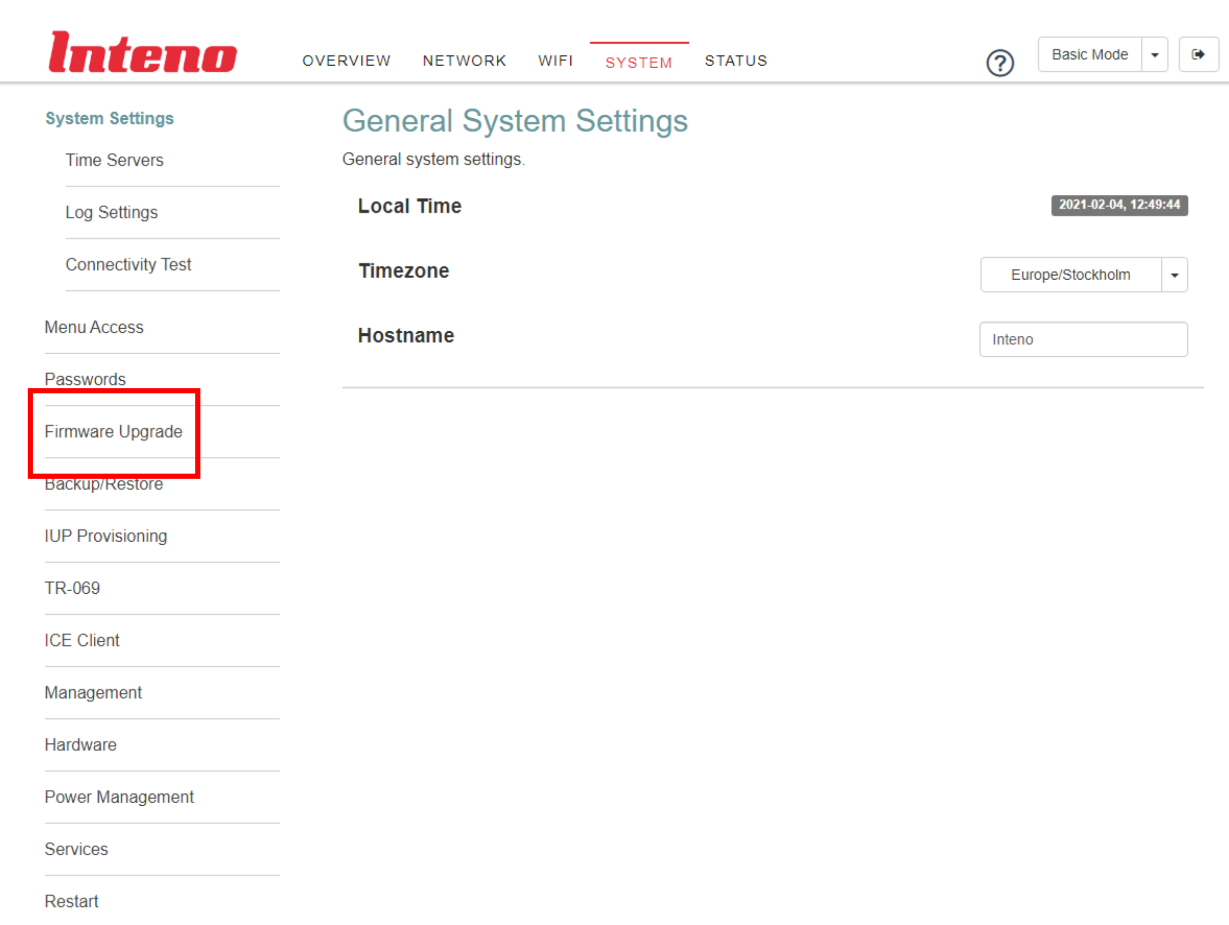

On the System page, press the Firmware Update button on the left menu. inteno-3

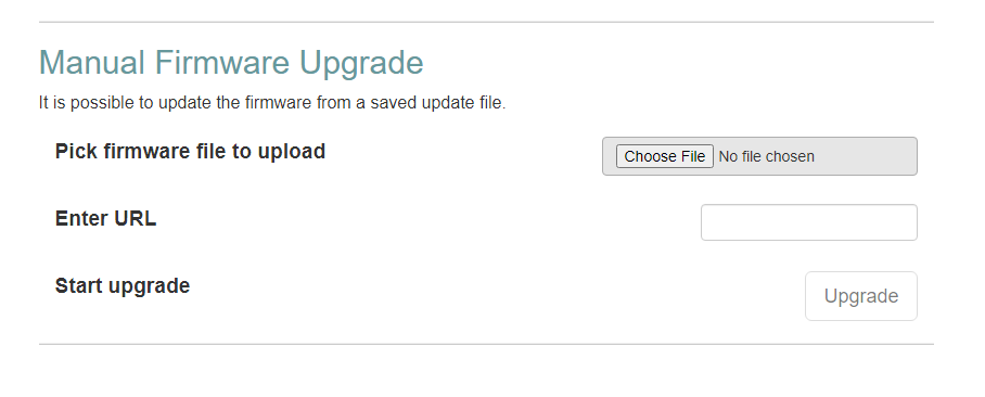

On the firmware update page, use the last step called Manual Firmware Upgrade. Select the downloaded y2 file using the file selector and click the Upgrade button. inteno-4
