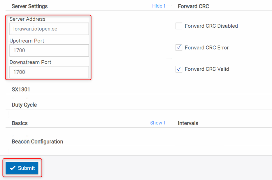

Multitech LoRa Gateway
This image illustrates where to find the Gateway ID for registration in the LoRa server. multitech_1
This image illustrates how to set the settings for connection to the LoRa server. multitech_2
