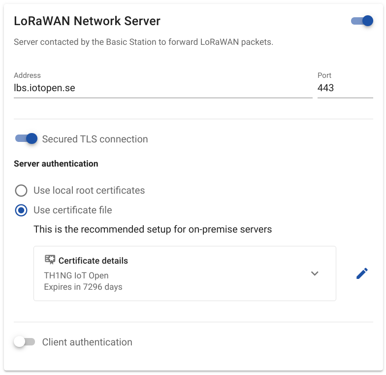

Basic Station
Address: lbs.iotopen.se
Port: 443
Secured TLS connection: ON
Use certificate file: Upload this file
Client authentication: OFF

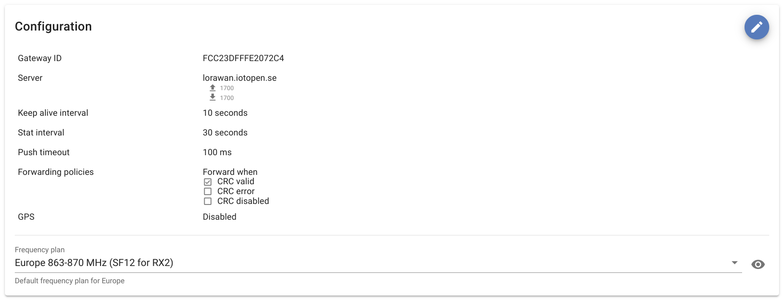

UDP Packet forwarder

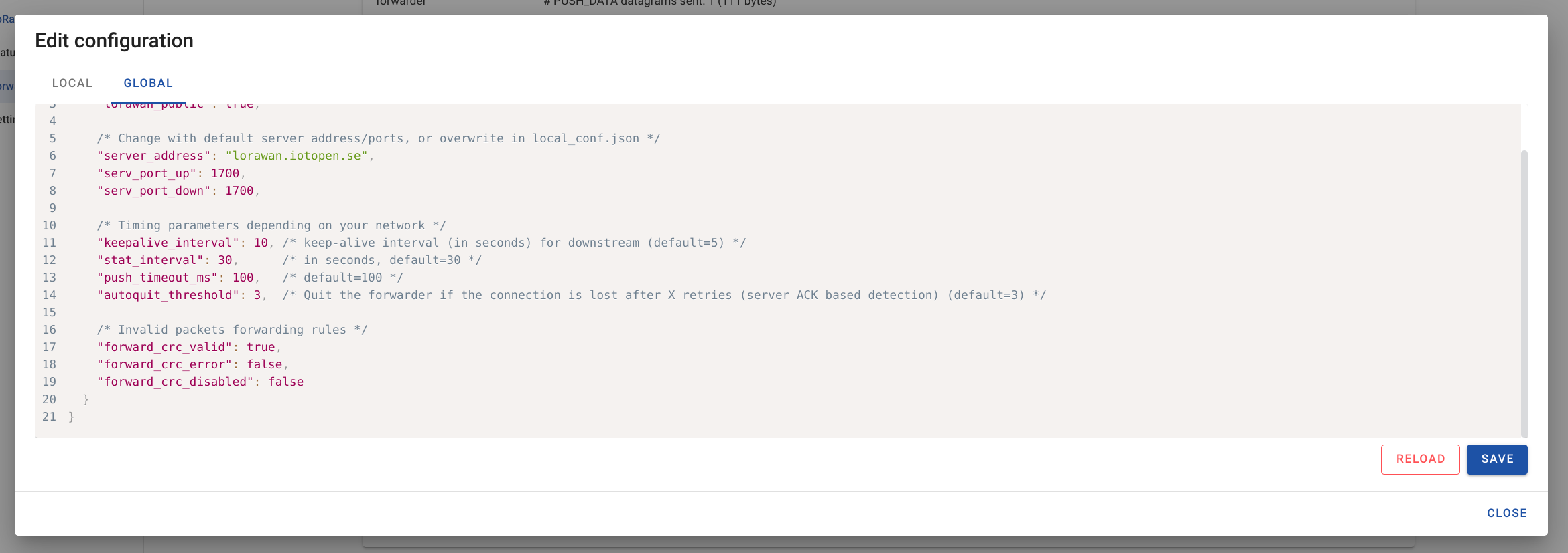

The UDP Packet forwarder is configured by edit the config file in the web based GUI. The following parameters needs to be changed.
server_address: lorawan.iotopen.se
serv_port_up: 1700
serv_port_down: 1700
These can be set in either the local or global conf. Below is some images showing the configuration.
