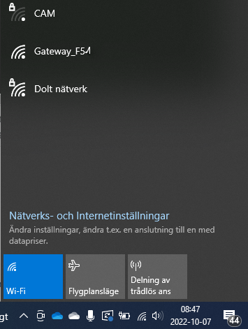

The Milesight UG65 has a web-interface for local configuration. To set up a new unit from scratch, power it up and connect to it via the built-in Wi-Fi hotspot. The gateway have a SSID named Gateway_ + the last charachters in the MAC address.

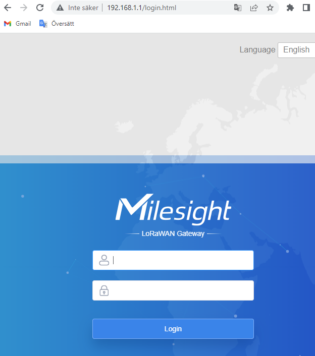

When connected, browse to 192.168.1.1
You can find the default username and password printed on the back of the unit.

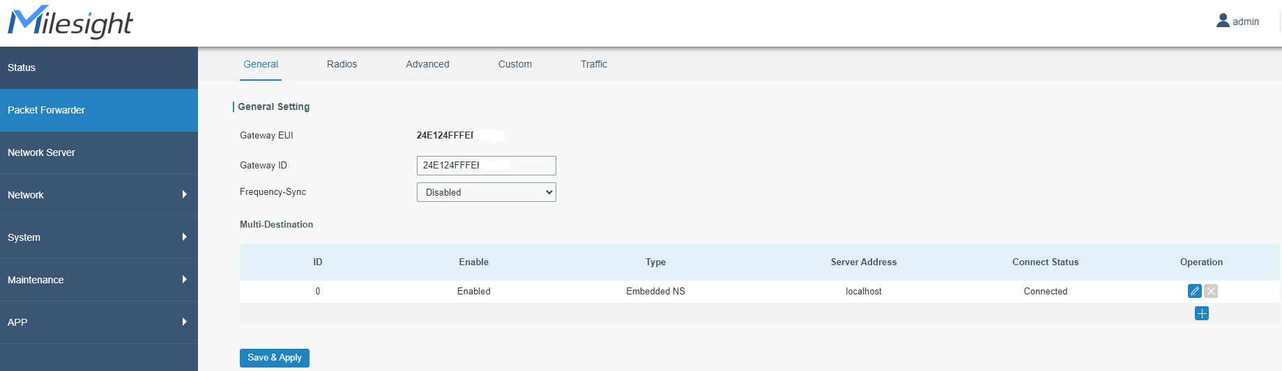

Packet Forwarder
To send the LoRa traffic to the IoT Open platform, you need to set up a Packet Forwarder.
There are two packet forwarders that you can use, the Semtech Common Packet Forwarder and the newer Basic Station.
For Semtech see Milesight Semtech.
Regarding Basic Station, the guide is not yet finalized. If you are in a hurry, don't hesitate to contact us.
